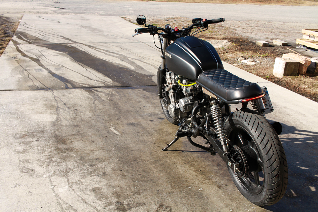

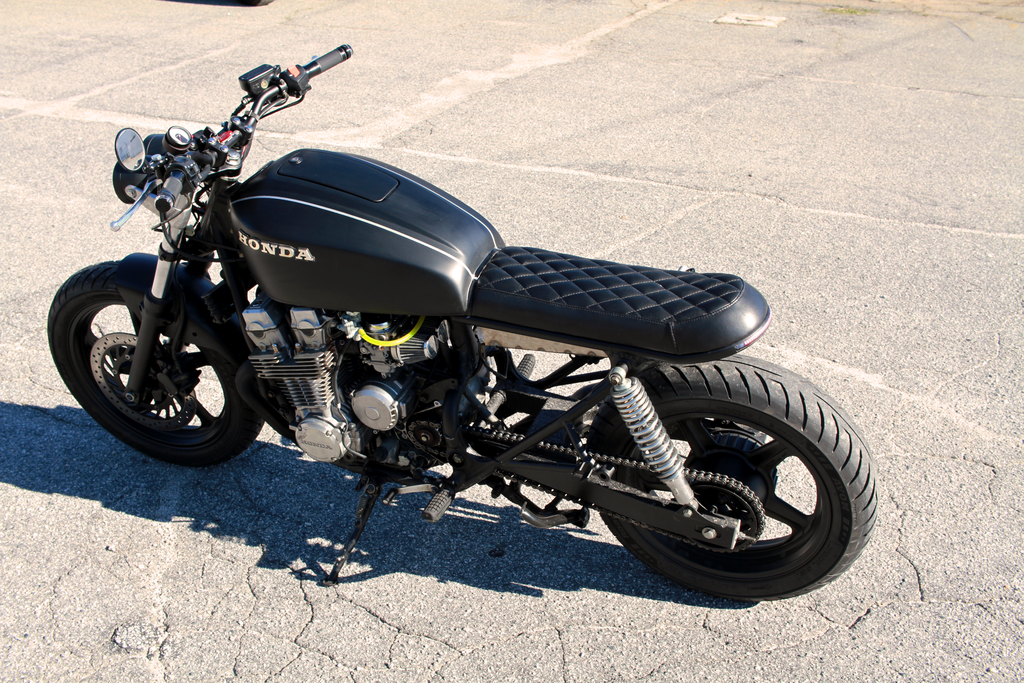

Before:
After:
Tank is from a 1978 CB750K. Seat from Ginger McCabe at New Church Moto in Portland. Renthal bars. Gauge and bar end turn signals from Motogadget. Everything else done by yours truly.
A few intermediates:
-- Had to machine a bushing so the existing vacuum-operated petcock would fit the new (old) tank. Works beautifully. NH threads are M20x1...yikes.
Fitting this tank was a nightmare... but worth it.
Still gotta get the electronics pan powder-coated, but that's about it. Droopy fuel line on this iteration because I was taking the tank on and off constantly for fitment. Nothing like flexibility.
YES, I got pods to work just fine.
Hoping to sell some of the intact stock parts. Original seat is pristine. All the exterior plastic is fine, (somehow) as is the airbox, rear fender, both mirrors, etc. Tank and exhaust are both up for grabs, but took some road rash. Let me know if there's any interest.

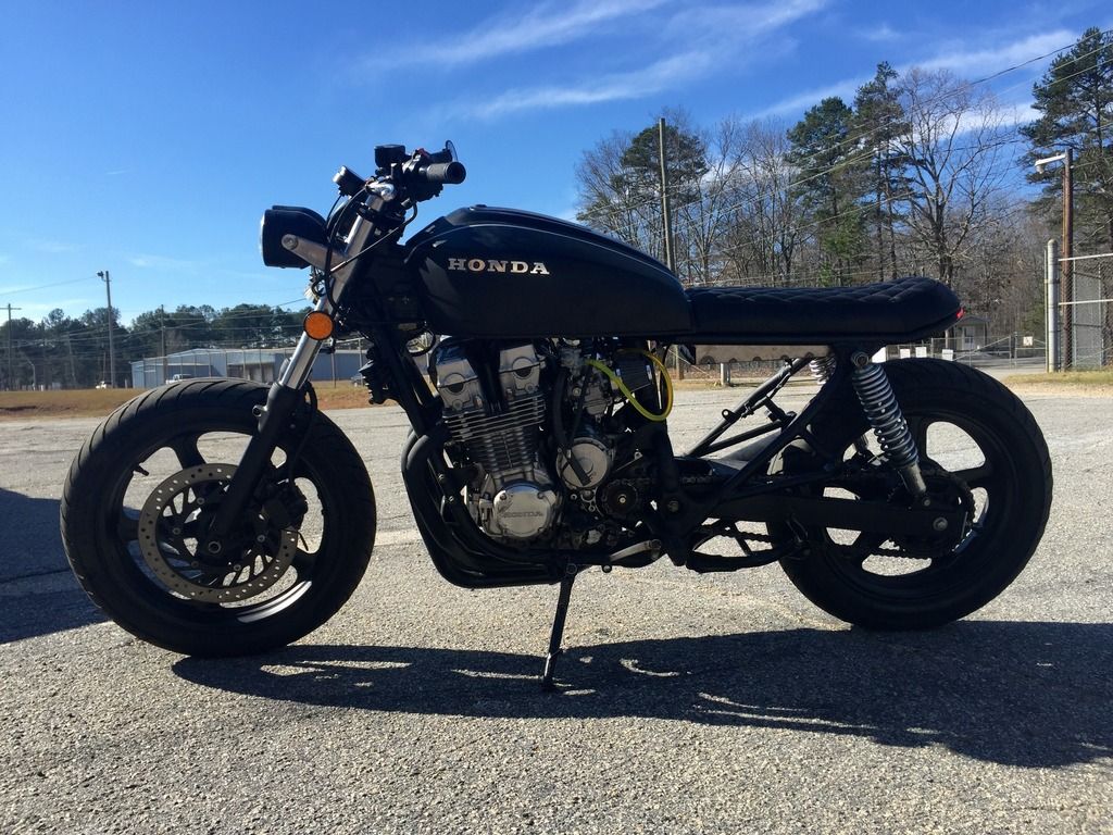

hate to be the guy who bumps his own thread, but oh well. after months of seeing other people/shops do wild fork conversions, i thought to myself - pffffffft. i can do that.
so, here's a 2008 kawasaki zx-10r front end all bolted up to my 1991 nh750. full disclosure: i am terrible at remembering to document progress with photos.
from what i hear, i probably could've used aluminum, but i made the stem out of 4140 chromoly. i'm gonna stick with aluminum next time.
did my own upper triple, too. included a flush-mount for my motoscope tiny. (honestly, don't buy stuff from motogadget. it's an expensive addiction. i started with one gauge, now i'm at turn signals and keyless ignition, AND i'm sketching up replacing my entire wiring harness. germans, my dude. always with the quality kit.)
finished! it's a charm. gotta put my dang headlight back on somehow.
