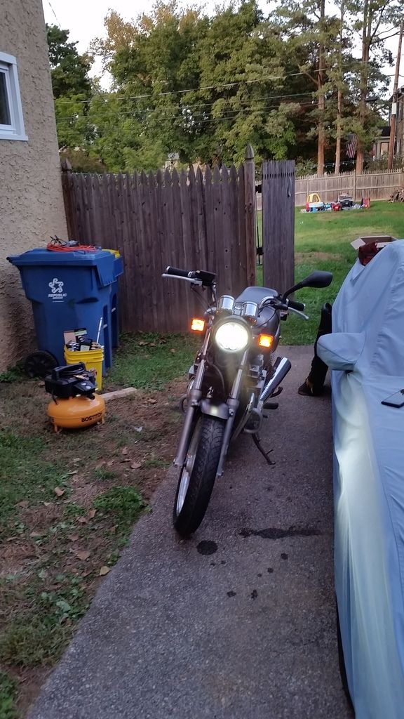

Hey all.  Name is Justin.  Figured I would share some pictures/story of my build.  Ill try to keep the yapping to a minimum.  There are also large gaps between pictures, mostly because I video a lot of my work for my youtube channel.  So still images arent as plentiful as they used to be.
To start...I used to own an 83 Honda Shadow.  It was ok...but had issues.  Rarely started easy, clutch ALWAYS slipped even after rebuilds.  I sold it off, bought a house, got married, had kids...etc etc.  My neighbor has had this Nighthawk sitting behind his house for years.  Ive always kind of looked at it, but really didnt have interest.  Knew he wanted to unload it... This past summer I made him an offer and he took it.  Got it for $150.  No keys, no title, and had been sitting for 8+ years.

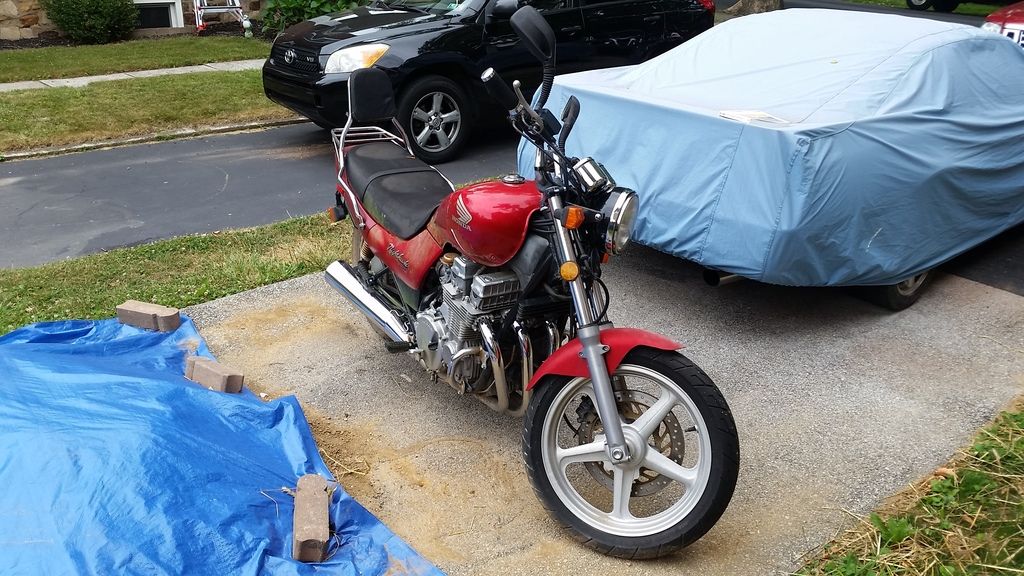

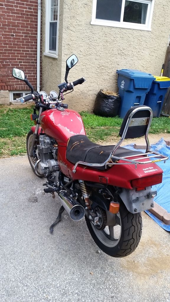

Here is how I got it.  Not even a wipe down yet.
First thing I did was order a key off "keys4urride.com", came in two days, and worked perfect.

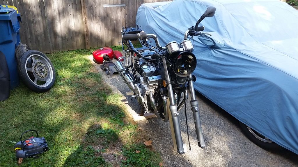

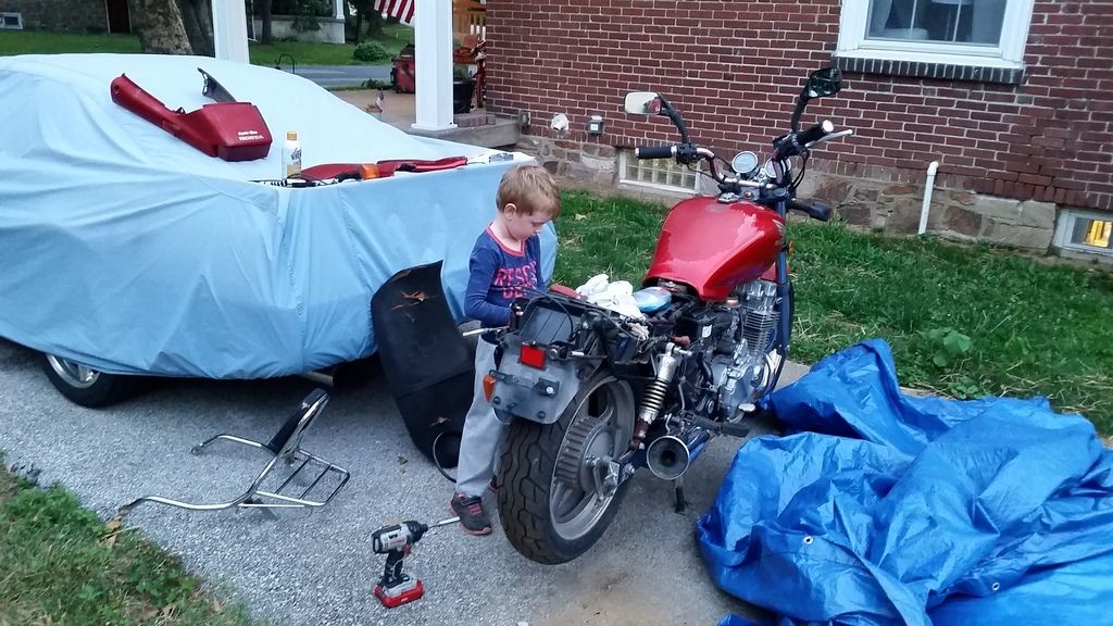

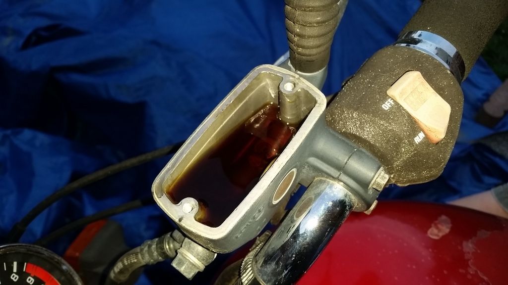

Before I even tried to start it, I started to disassemble.  I wasnt in a hurry to ride, didnt even think I would this year.  So with my son helping, we started to strip it.  Tank was clean, brake fluid was gel, caliper seized, tires were cracked, and mice had made homes in all nooks and crannies.

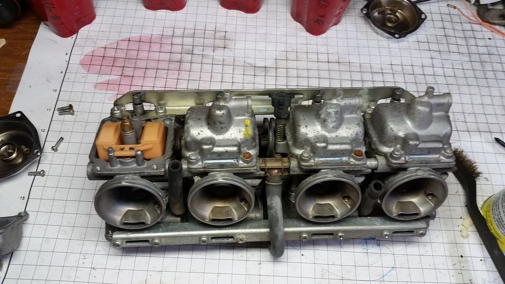

Put in new plugs, changed the oil, cleaned out the airbox and used a new filter.  Then cleaned the carbs out.

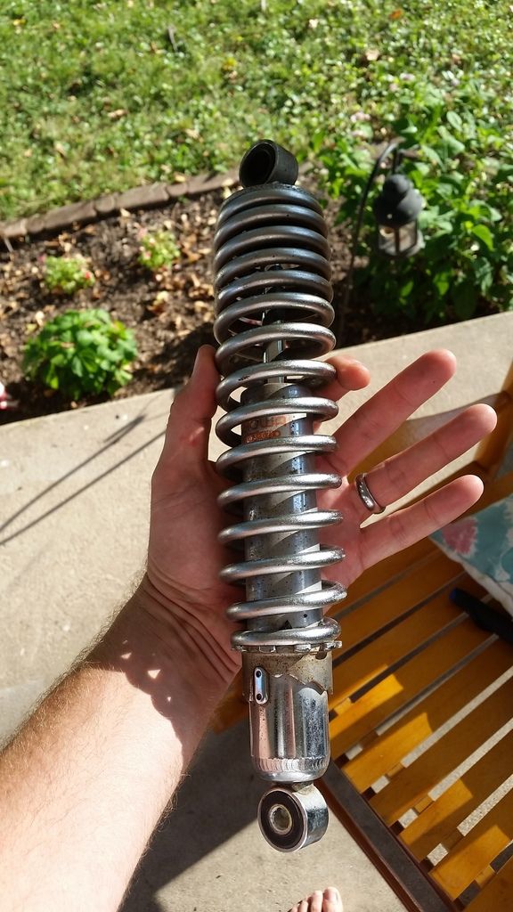

Seat was trash, so I got a mint one off ebay, along with decent stock shocks.  Paid less than $100 shipped for both.  Shocks that were on there were lowering shocks.  They didnt even let the kick stand work properly.
Put things back together roughly, and fired her up!  Got the first start on my channel if anyone is interested.

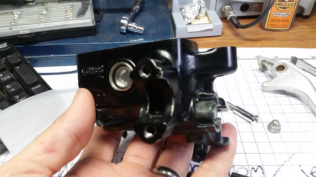

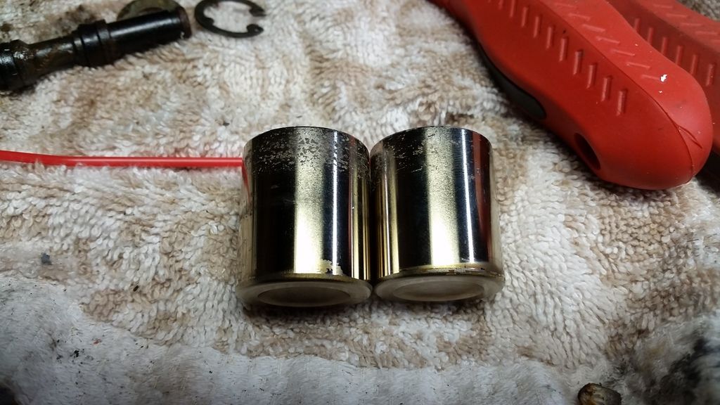

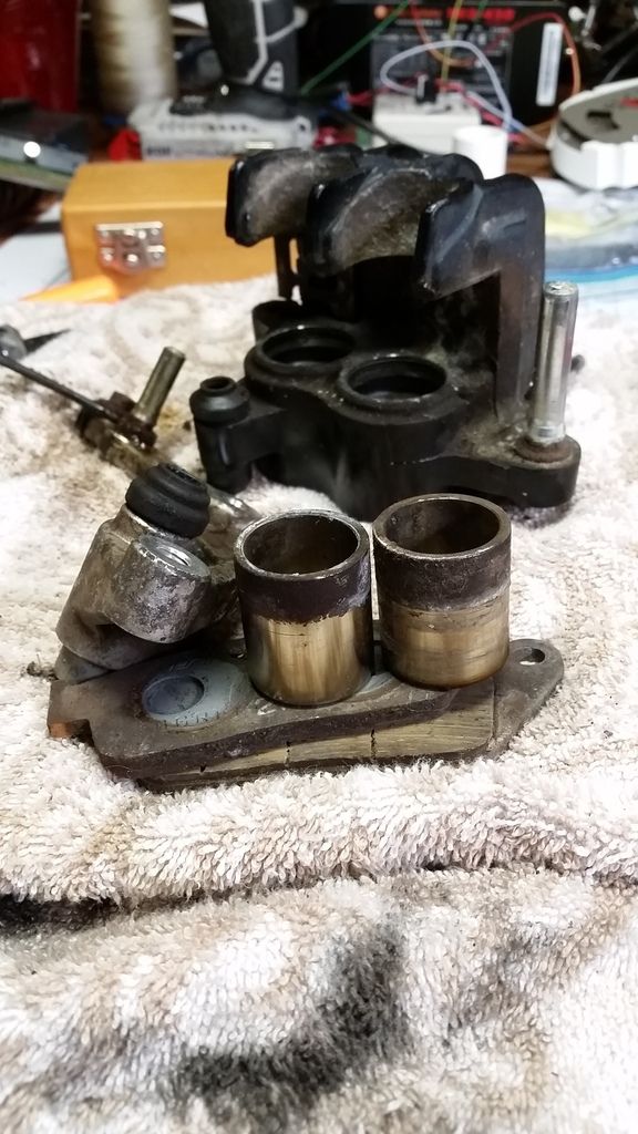

Had to rebuild the master cylinder and the caliper.  Pistons were so pitted I had to buy new ones.

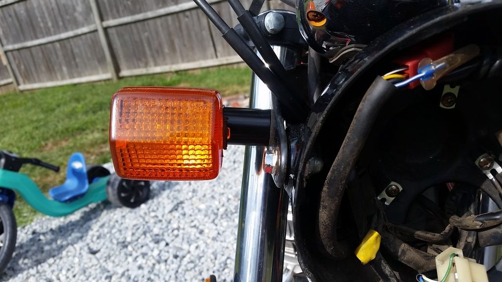

Also rebuilt the signals.  The old rubber stems were junk and the signals were flopping around.

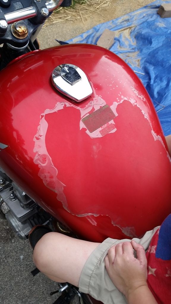

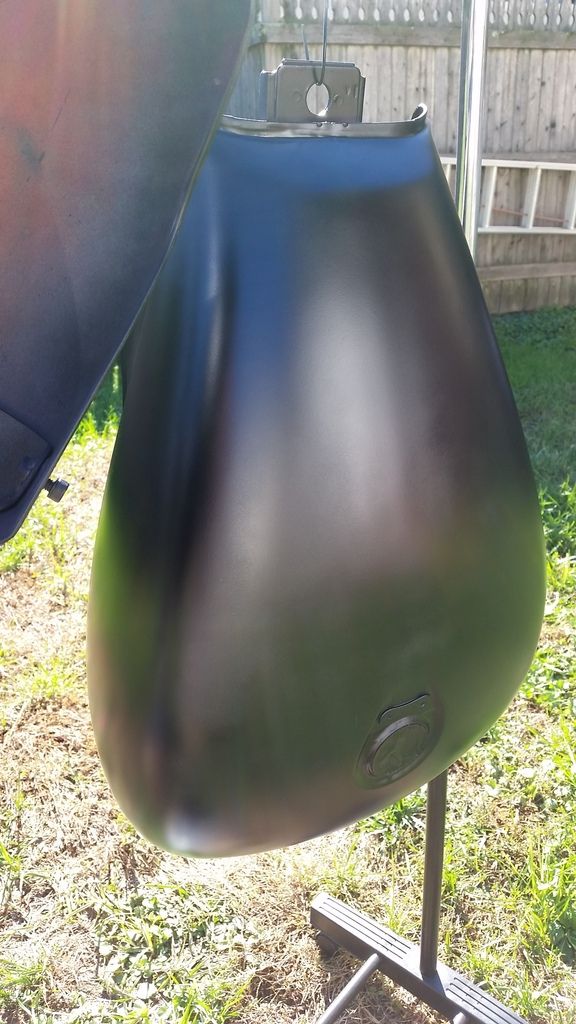

So after this, the bike sat for a bit.  I wasnt really ready to do major work to it.  Plus didnt really have time.  Out of nowhere....I decided to really push to put the thing back together and ride it.  I was going to do a full paint job, but decided I just wanted it to look nicer and all one color.  I also wanted to mount an Auxbeam LED headlight, which was a project in itself.  So I tore it down the rest of the way.

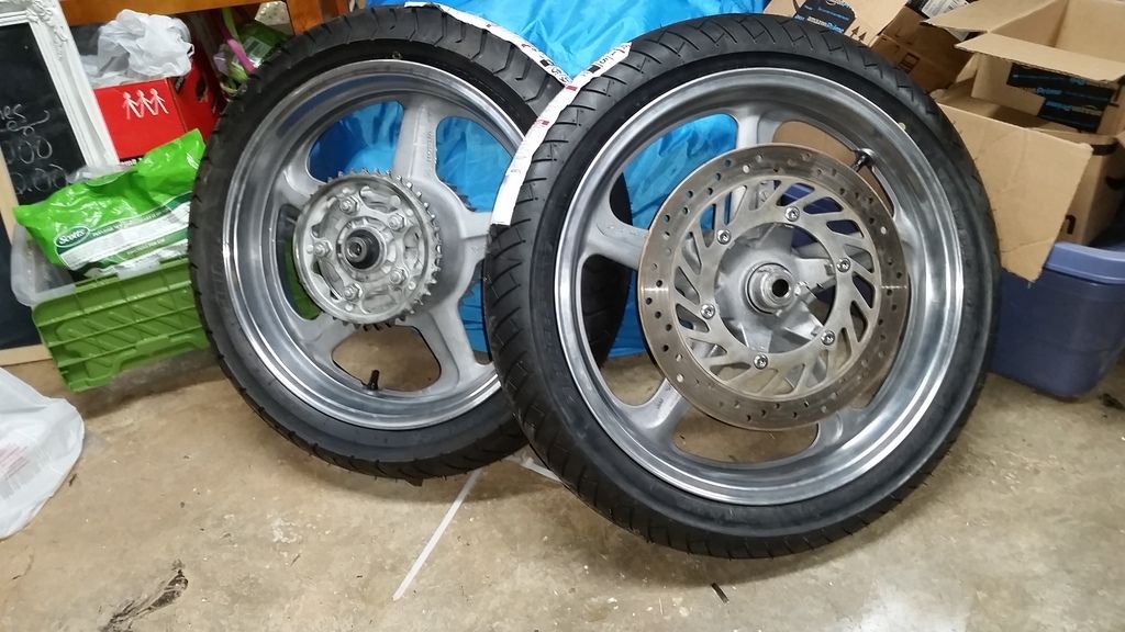

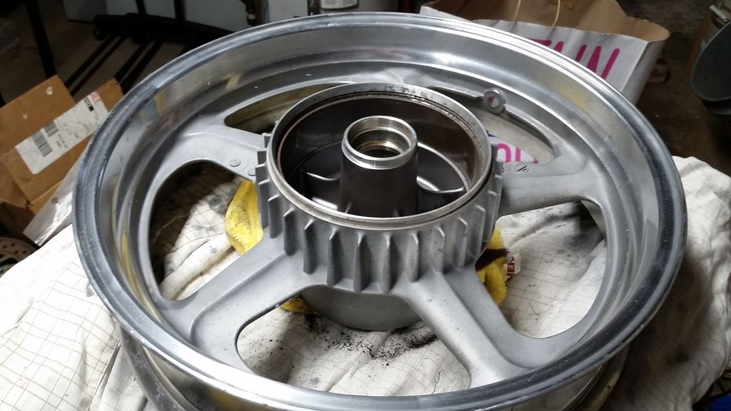

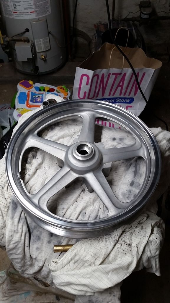

Couple pics of the wheels being cleaned up, paint being sanded, etc.  I also mounted my own tires and used balance beads.

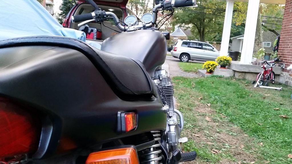

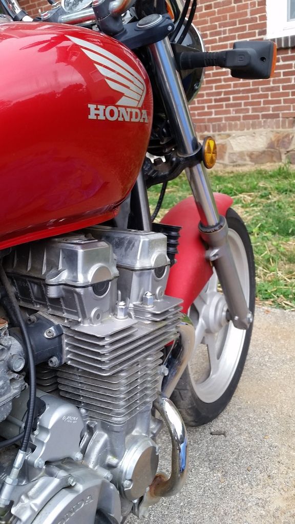

So this last set of pictures all took place during one day off work.  I got started around 10 am, and took my first ride around 4 pm.  Painted first, got carbs on, and just started to bolt things back together.  By the time I was ready for the body parts, the paint was dry enough to handle.
Thats it!  Been riding it as much as I can before PA weather moves in.  The past couple of 80 degree october days have been nice!  The bike runs great.  No problems, good power, lots of fun on the twisties.  REALLY missed riding.  Im not sure if Im even going to re-paint it now.  The satin black kind of grew on me, and Im starting to dig it.  So Im not really sure what the plan is.  Just going to enjoy her!
Only things I need/want now are new bars (they were bent), new mirrors, and new grips.  The rest is ok to stay how it is for a while.
If you want to check out my channel its www.youtube.com/jegsgarage

I am trying to determine if my rear shocks are junk. They don't seem to dampen as they should. They could just be horrible even when new for all I know.

And yes I did get new tires. Removed the old ones myself, cleaned up the wheels, new valve stems, new tires and used balance beads to finish it off.

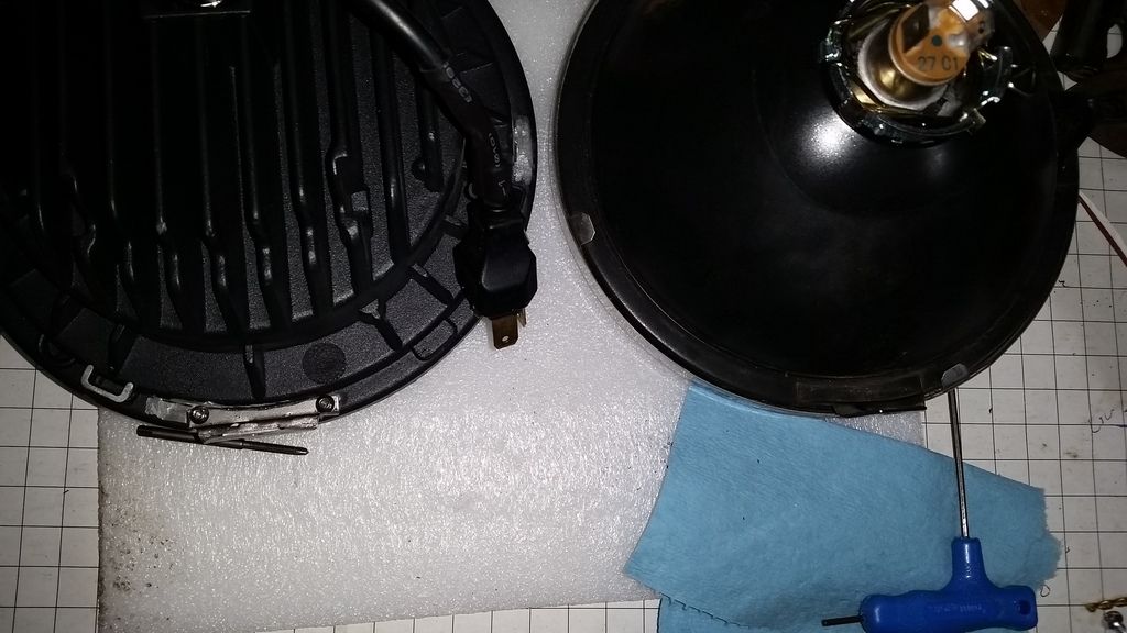

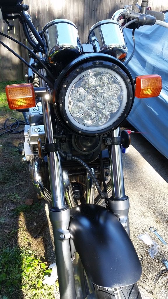

I have a question please. How is your LED headlight performing and where did you get it.Any mods to wiring? thank you

As for the headlight...Im going to do a post about it.  I have had a bunch of questions.  Its not a bolt in light for sure. The size is good...but there are no mounts on the light.  Its designed to work in  Jeep.  So I had to fabricate the mounts, which wasnt hard.
The payoff was great though.  The light is EXCELLENT in my opinion.  Tons of light on low, and the high beam actually works unlike with some LED lights.  Again, this is just my opinion.  About 50% of my riding time since I built the bike has been in the dark, and its been great.

What was your method of getting those wheels so clean and polished? They look like new!

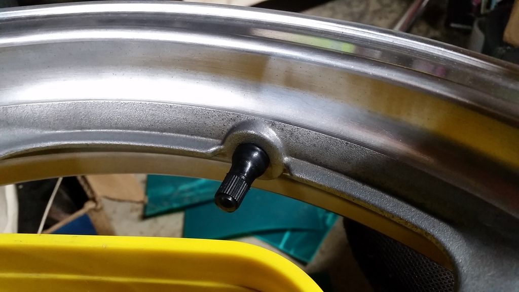

For the polished area, I planned to really spend a lot of time, but ended up taking a short cut...which ended up looking fine haha.  I didnt want them smooth as glass, I liked the machined finish.
So I started by cleaning really well.  Then I used red scotchbrite to just knock off any rough crap.  Then I just did a quick wetsand with 800 grit wet/dry paper.  That got out most of the little spots and stains.  Then I hit it with a foam ball and some mothers alum polish.  That stuff is amazing.
For the center section...On the front wheel, I just used a combo of wire wheel and the red scotchbrite.  The rear wheel, I actually sandblasted the middle part.  Came out nice and clean.
I might take them off and go after them again one day, but they came out plenty good considering the condition of the rest of the bike.

Just wondering, have you tried to adjust the shocks to a higher setting? Don't they tighten up a little?

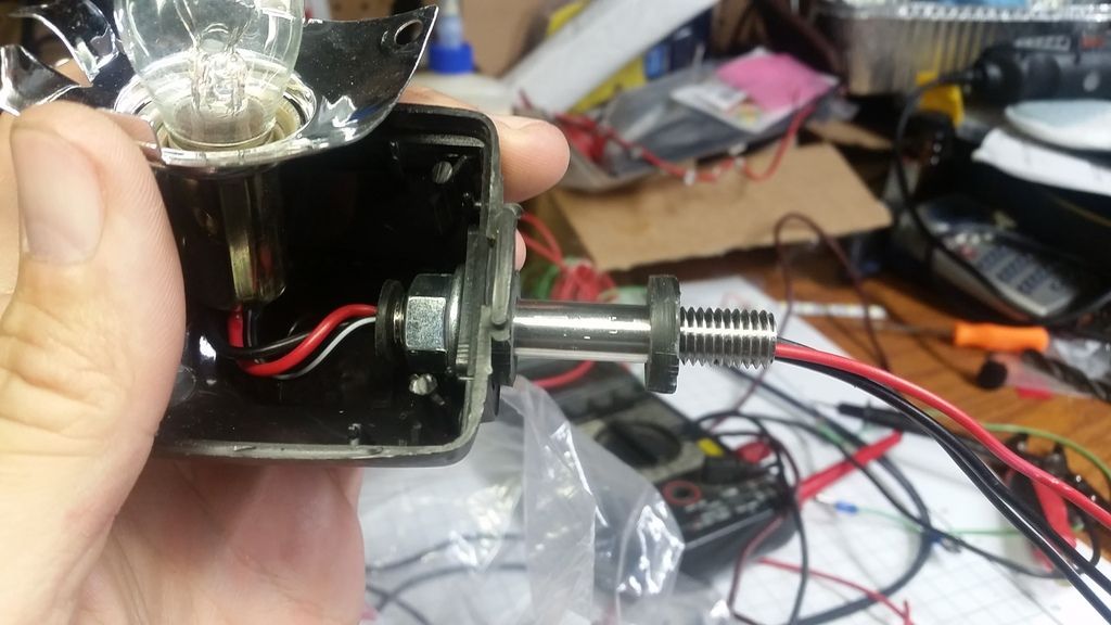

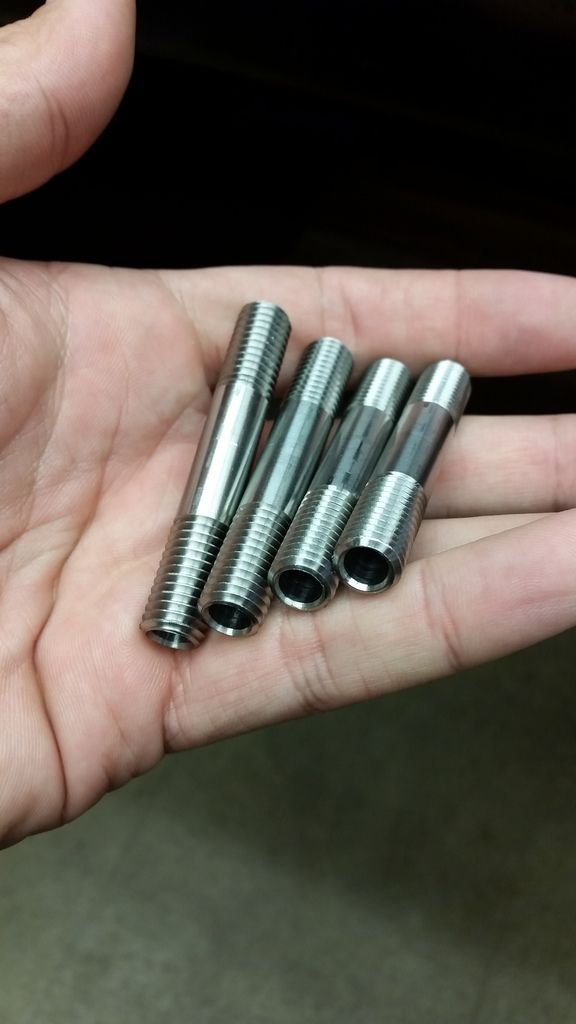

Kudos on the Nighthawk rehab!  Where did you get the turn signal stalks?  Did you machine them from raw stock or were they purchased from somewhere?

Is the headlight DOT-approved?
